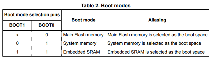

The Schematic Pack is in line with the boot modes table described in the reference manual RM0090 and precisely in section 2.4.

> why the BOOT1 on a Nucleo board is floating by default.
My understanding is that BOOT1 was kept floating in Nucleo-F429Zi in order to allow the user to select suitable boot memory (setting the solder bridge) depending on his needs:
- If the system memory is selected as the boot so, the BOOT1=0 and BOOT0=1.
- If the embedded SRAM is selected as the boot so, the BOOT1=1 and BOOT0=1.
Thanks,
Kaouthar
A pull-up/down still allows the user to force the pin to the opposite level. If the BOOT1 would be pulled down through R73 100k by a closed SB152, then, when the user sets BOOT0=1, by default the MCU would boot the System bootloader, which is necessary more often that booting SRAM. But now it's unpredictable. And adding a 100k pull-down on one of the pins will rarely interfere with other usage of that pin even without disconnecting that pull-down.
