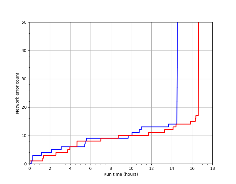

A little update.
Following Joerg's advice I switched to SW32STM32. Surprisingly, the version compiled with the arm-gcc compiler (yet again, using the default compiler settings) seems to be somewhat more stable (although, still not perfect). I ran two consecutive tests, identical to ones described in my post above. Essentially, I was continually pinging the H7 devboard and parsing the out-coming response. I incremented my error count whenever I received a time-out or a "Destination host unreachable" response. The error accumulation results are presented in the graph below:

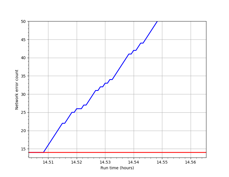

During the runtime, I received a time-out ever so often, but the device was operational nonetheless. After running for about 14 h on my first run and about 17 hours on my second run, one of the midlewares seemingly crashed. The the sharp rise in the accumulated error count graph indicates that a "Destination host unreachable" error was received each time that the device was pinged. I am attaching a zoomed-in version of the error accumulation graph just for clarity:
0690X000006CwQeQAK.png While 12+ hours of stable operation is a good endeavor, it is still not satisfactory for a device that is supposed to be connected to the network 24/7. I will run a few more tests (e.g., on an older version of the firmware and on the latest without modifying ethernetif.c, as suggested by Joerg) and I will present the results of my tests.
