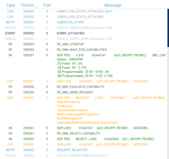

It didn't at the last image, when I requested the 3.3V-5.9V APDO with 3.3V. The last message is "DEBUG 607514 REQUEST not accepted by the stack", which is the response to this last request.
About the VBUSGetCurrent function, I tried copying the code from VBUSGetVoltage, changing variables and the multiplier but can't seem to make it work as I get false current readings (when comparing with multimeter and with current oscilloscope probe too). Where can I find a code exemple that really works?
Here are all the traces in text, even though SRC CAPA can be seen coloured at the first image:

FelipeFRL
Dear @HFISTM​ ,
I'm debbuging the hell out of this aplication, and the problem seems to be within line 432 of usbpd_user_services.c file. The USER_SERV_SNK_EvaluateMatchWithSRCPDO function passes only the max possible voltage to the RequestedVoltage variable used in ResquestMessageRequest function, then causing its if condition of equality between voltage and RequestedVoltage to be False, which then traces the Debug message "REQUEST not accepted by the stack". I just don't know what value to use on line 432 for it to proceed in the right way.
After commenting out this line, the application seems to be out of control, as it won't establish a contract. The hardware it keeps unstoppably requesting for the APDO to be instated, rejecting the request and then resetting, over and over.
Here you can see one iteration of this unending cycle of madness:

HFISTM
Hello @FelipeFRL​ ,
Thanks, I've understood the issue.
Could you please try the following fix ?
Please replace line 427 to 439 (the whole block if (((srcminvoltage100mv <= snkmaxvolta ...) by:

Thank you for your feedback regarding this bug, we will update the x-cube-tcpp package to fix it shortly.

FelipeFRL
Thanks for the response!!
It didn't work, I can't even request the PDOs now. I made a sketchy but honest solution, but it can't be passed to the tcpp example as it won't work with other Source devices. It seems like your solution is way smarter and the right one to be passed to the tcpp example, it just needs to work.
HFISTM
Hello @FelipeFRL​ ,
Please try with the original code from x-cube-tcpp without any modifications but the one in this thread. (USBPD_DPM_RequestMessageRequest modification + the code I just sent above).
It worked on our side so ensuring that we are aligned on the same code would help.
Thanks
FelipeFRL
It seems to have worked, that fixed the original problem, but I have other problems now. It won't finalize the request made even though it has recognized the request correctly. Every subsequent request I make (even get_status, or requestHardReset), it gets status USBPD_BUSY and then traces REQUEST not accepted by the stack.
Any clue?
Its not relevant yet for you but I hope someone will find this answer useful. The VBUS_Get_Current() function example can be found in CubeMX examples for G0 boards: STM32G081B-EVAL. You need to open the DemoUCPD project in CubeIDE, for me the path is:
