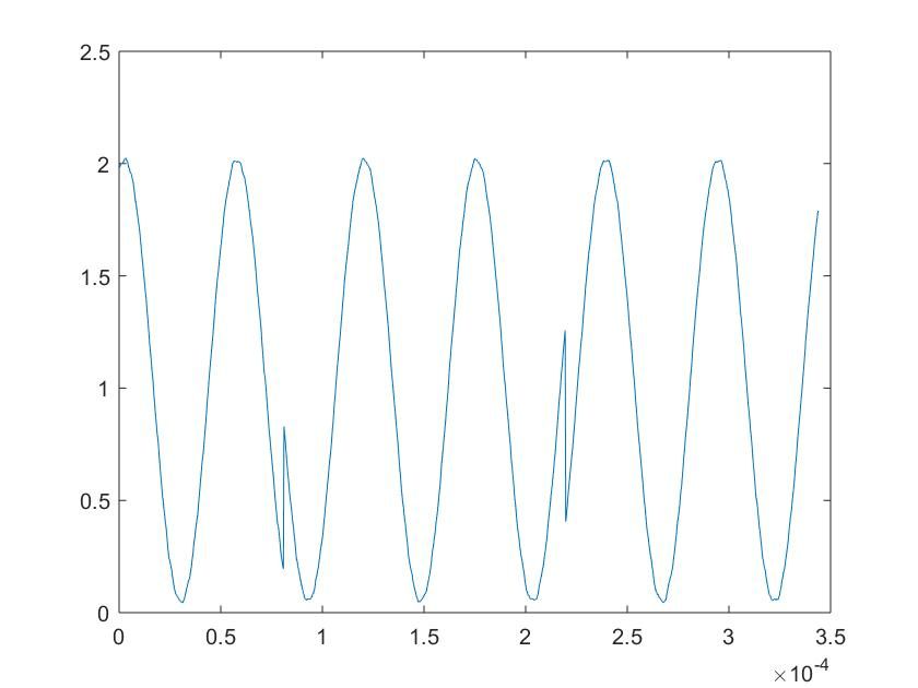

I found the solution for this matter, It was my bad (wrong connection) and now it works properly. However does anyone know how to store the data stream from the ADC stream without loss on my µSD. I just modified my main to write the data into a .bin file to avoid sprintf() function, but I still loose data as you can see on the graph. 0693W000003C0c6QAC.jpg
Do you have any advice to store these datas ?
Best Regards
Mathieu
