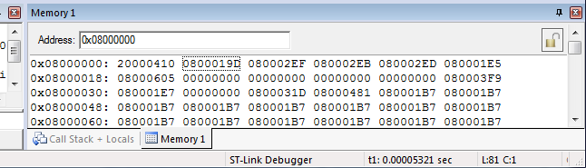

Posted on April 04, 2014 at 13:36
Look, you're not trying to jump to 0x08000004 but the content pointed TOO by it, indirectly.
You also don't want to be jumping to the main() function because it would ignore all the C runtime startup code which copies your statics, and clears your initial variables.
Observe the ODD address of the code that is supposed to get jumped too.
Posted on April 04, 2014 at 13:45
My next function is going in hardfault handler, why?
Poor cut-n-paste job? Tried stepping through it with a debugger?
void FLASH_Bootloader(void)
JumpAddress = *( (uint32_t *)0x08000004); // Load the ACTUAL content for initial PC
Jump_To_Application = (pFunction) JumpAddress;
/* Initialize user application's Stack Pointer */
__set_MSP(*(__IO uint32_t*) 0x08000000);
Jump_To_Application();

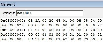

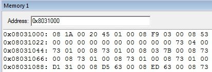

tommelou
Posted on April 04, 2014 at 15:28
Thank you for replying and the screenshot,
this function is now working, but i'm reseting in loop.
And when i'm pointing to the second binary at 0x8031000, with the same software than binary1 I have the same address pointing to 0x80000145
and
So it point to the same point at first binary.
chen
Posted on April 04, 2014 at 15:37
Hi
''And when i'm pointing to the second binary at 0x8031000, with the same software than binary1 I have the same address pointing to 0x80000145''
The second version of the application need to be located differently.

Posted on April 04, 2014 at 16:14
You have to build two different binaries, as the Vector Table contains fixed/absolute addresses. To do this in Keil you have to modify the IROM(1) range in the Target dialog pane.
For examples to Boot Loader + App, review the IAP USART example code, and search also the forum where I covered this all before.
