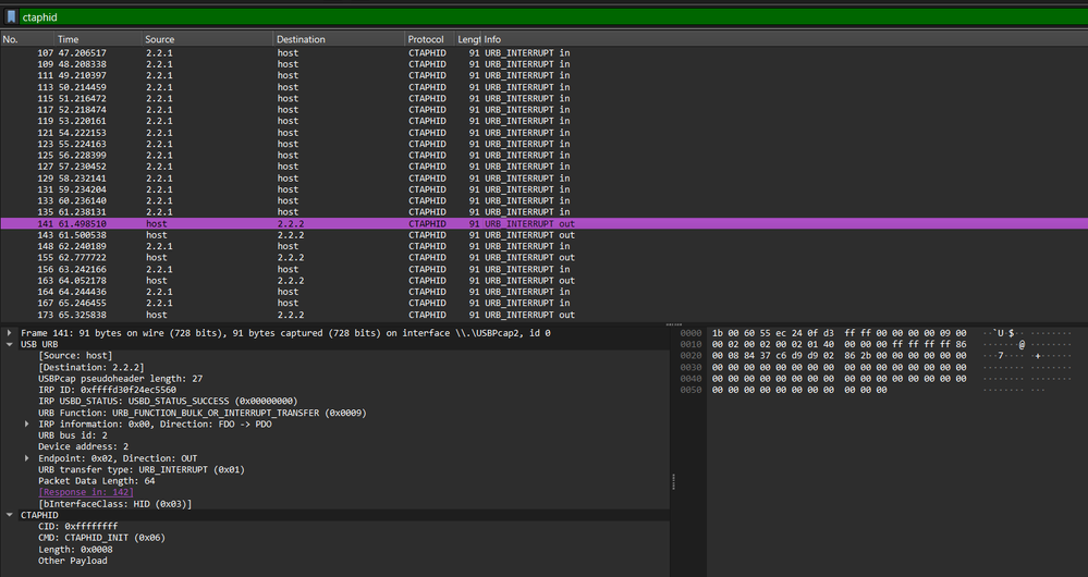

To send data to my board, I use the WebAuthn site, which allows simulating the registration of a FIDO2 security key. My STM32H573 is configured to be enumerated as a "HID-compliant FIDO" device. I have attached my descriptor file below.
During registration, the site is supposed to send data to the authenticator device via the CTAP protocol on the OUT endpoint.
I have also tested with STMicroelectronics' USB HID Demonstrator tool and can see that data is successfully transmitted from the STM32 board to the host. However, when I send data using the SET_REPORT command, the associated callback function is not invoked; only the SET_FEATURE function works.
‎2025-05-19 8:15 AM - edited ‎2025-05-19 8:16 AM
Hmm. When an output report is sent to device, do you see any data received by the device at the USB level (any endpoint received any data)? Or the problem is that a host cannot be convinced to send output reports?
‎2025-05-19 9:20 AM
I observed with Wireshark that when I initiate the enrollment step with WebAuthn, the host sends data to the OUT endpoint :
The issue is that the USBD_Custom_HID_SetReport callback function in my program is not being called.
If you have any insights or suggestions to resolve this problem, I would appreciate your assistance.

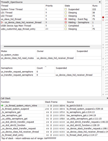

‎2025-05-20 1:30 AM
While debugging, I noticed that the ux_device_class_hid_receiver_thread goes into a semaphore wait state and remains blocked, even when registering on WebAuthn. Yet, with Wireshark I can clearly see data arriving on the OUT endpoint.
I placed a breakpoint on the return statement of the USBD_Custom_HID_SetReport function in the file ux_device_customhid.c, but it never gets triggered.
In the file app_usbx_device.c, I have correctly initialized the OUT endpoint:
#ifdef UX_DEVICE_CLASS_HID_INTERRUPT_OUT_SUPPORT
custom_hid_parameter.ux_device_class_hid_parameter_receiver_initialize = ux_device_class_hid_receiver_initialize;
custom_hid_parameter.ux_device_class_hid_parameter_receiver_event_max_number = USBD_Custom_HID_EventMaxNumber();
custom_hid_parameter.ux_device_class_hid_parameter_receiver_event_max_length = USBD_Custom_HID_EventMaxLength();
custom_hid_parameter.ux_device_class_hid_parameter_receiver_event_callback = USBD_Custom_HID_SetReport;
#endif /* UX_DEVICE_CLASS_HID_INTERRUPT_OUT_SUPPORT */
Please find below the USBX files from my project.
