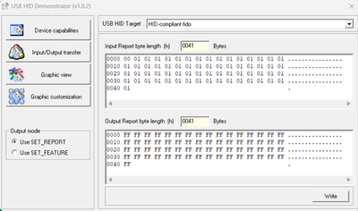

I also tested sending data using the USB HID Demonstrator (v1.0.2) software.
The GET_FEATURE command works, but SET_REPORT does not seem to trigger any callback on the firmware side.
USB HID Demonstrator available here.

To receive IN or OUT report requests in the device, the host must make these request. Otherwise the device won't see anything. Can you show the host code sending these requests?
‎2025-05-19 2:30 AM
Hi @Pavel A. ,

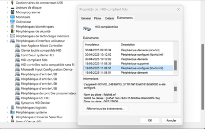

To send data to my board, I use the WebAuthn site, which allows simulating the registration of a FIDO2 security key. My STM32H573 is configured to be enumerated as a "HID-compliant FIDO" device. I have attached my descriptor file below.
During registration, the site is supposed to send data to the authenticator device via the CTAP protocol on the OUT endpoint.
I have also tested with STMicroelectronics' USB HID Demonstrator tool and can see that data is successfully transmitted from the STM32 board to the host. However, when I send data using the SET_REPORT command, the associated callback function is not invoked; only the SET_FEATURE function works.
