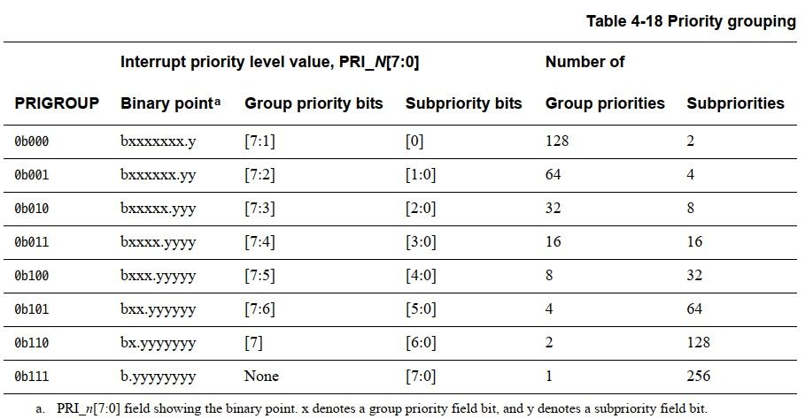

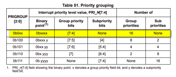

Pavel A.
January 19, 2023
Below is table from ARM CM4 generic User Guide document (ARM DUI 0553A):
In text above the table: "Implementations having fewer than 8-bits of interrupt priority treat the least significant bits as zero"
0693W00000Y8goAQAR.jpgSTM32 CM4 (and CM7) implement only 4 bits of interrupt priority, so when all 4 bits are assigned to preemption priority, nothing is left for sub-priority.
So yes, values 0 to 3 (b'0xx) have same effect.
