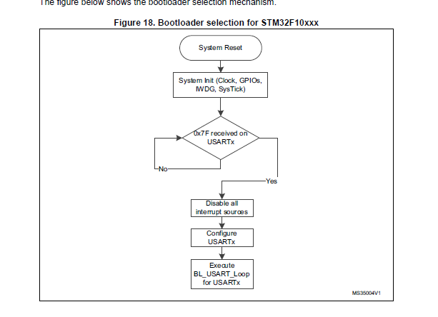

Hi
I would like to know, if it is possible to flash my FW via CAN1 on a STM32F103 or only via USART1?
AN3154 mentions the F1 series but AN2606 does only mention USART1.
Thanx
Andy

‎2023-05-05 12:36 AM
AN3154 discribes CAN protocol and applying it in supported devices, common for all mentioned Fx series, but AN2606 describes in details what channels are support. For STM32F10xxx only USART1 is supported.

‎2023-05-05 12:36 AM - edited ‎2023-11-20 6:25 AM
even the algorithm describes it:
