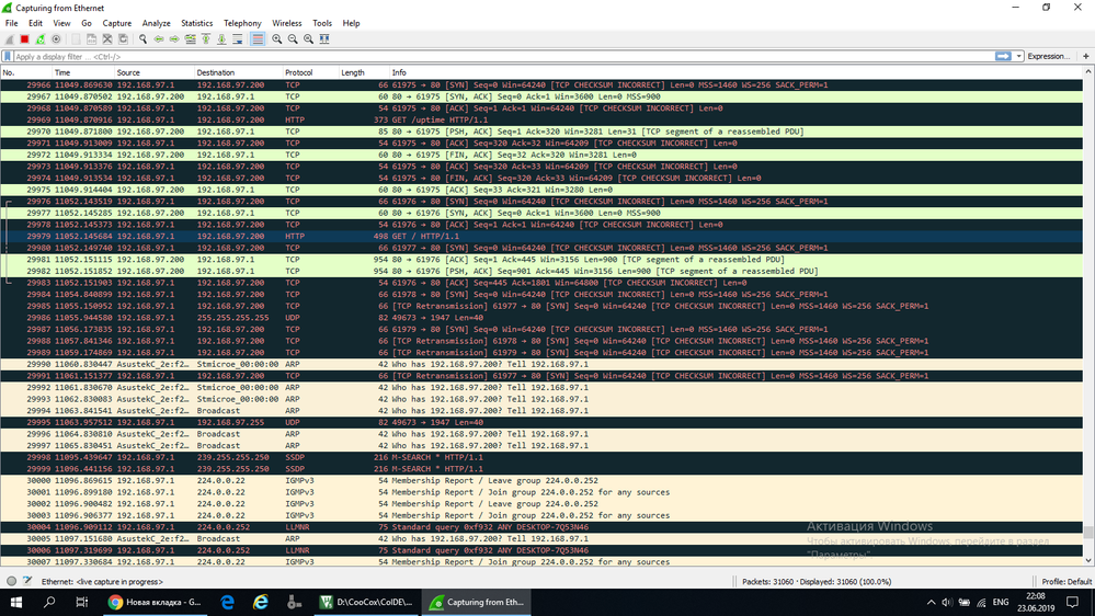

Recently I switched to STM32F767ZI using LAN8742A and the LWIP library. Began to develop a web configurator based on this STM. And there is such a problem. 0690X000008j6C9QAI.png
where 192.168.97.200 is a device, 192.168.97.1 is a client (computer).
During data transfer to get, the request goes to a packet with the SYN flag, after which the device does not transmit data, does not respond to ping.
The code is presented below.
