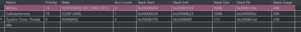

I am encountering a HardFault in the System Timer Thread which I am struggling to understand and resolve.
I have 2 threads with the same priority. Each thread also has a queue. The first thing I did when I encountered the Hardfault is check the stack usage and also increase the stack usage for each thread.
0693W00000KcJZaQAN.jpgOne thread is sleeping and the other thread is suspended waiting for a message from a queue.

Using the Fault Analyzer view in STM32CubeIDE I see an IMPRECISERR. I look at the register content at the fault exception and the PSP (Process stack pointer) is 0x2000b848 which is in the System Timer Thread stack.
When I exit my Hard Fault hander I see that the function the code was running when the error occurred is:
#ifndef TX_TIMER_PROCESS_IN_ISR
VOID _tx_timer_thread_entry(ULONG timer_thread_input)
Since all the stack sizes appears to be more than what is being used and the location of the cause of the exception I'm stuck on how to proceed.
I have tried also increasing the size of the system Timer Thread from 512 to 768 but the same fault occurs
