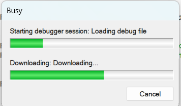

I download an example GUI from Touchgfx designer, generate code and run on my STM32H735G-DK board, it works well.
Then I open the .ioc of this project and generated code with EWARM, open it and build, it has no errors.
When I download it to board, the progress seems stuck and report error several minutes later.

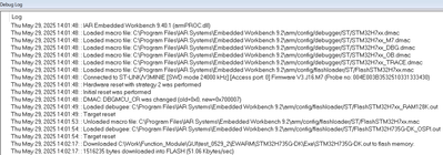

Here is the debug log,
Touchgfx version: 4.25.0
IAR version: 9.40.1

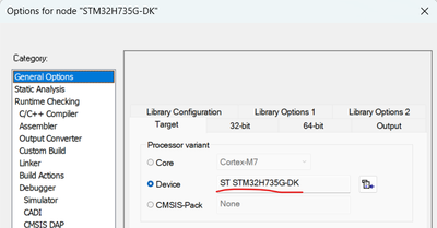

‎2025-06-11 7:50 PM
I have checked it out. The example project generated from TouchGFX is not correctly configured in IAR.
Select the right chip can solve this problem.
