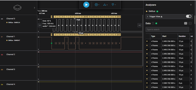

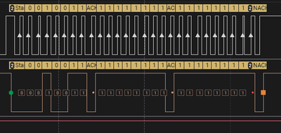

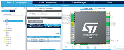

Hello @Karl Yamashita,
        Please see the attached bq25720_evm.pdf. I connected L4 series SDA and SCL lines, and everything I did for your information was implemented; please review the logic analyzer output of SMBus lines.

SMBus_master_receive_is not acknowledged, with log status FF FF.

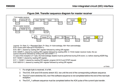

Hello @PSR1
It is the normal sequence according to the reference manual RM0090. A NA bit is sent after the last byte received.
Your SMBUS setup work fine, however, you need to check if you are receiving the good data. If not, you should investigate more.
