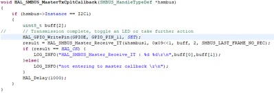

"I'm transmitting the address using this function:
HAL_SMBUS_Master_Transmit_IT(&hsmbus1, 0x09 << 2, buff, 2, SMBUS_FIRST_AND_LAST_FRAME_NO_PEC);
I placed the code to turn on the LED inside the function:
HAL_SMBUS_MasterTxCpltCallback(SMBUS_HandleTypeDef *hsmbus);
However, I am unable to receive a response when using the following receive function:
HAL_SMBUS_Master_Receive_IT(&hsmbus1, 0x09 << 1, buff, 2, SMBUS_FIRST_AND_LAST_FRAME_NO_PEC);"

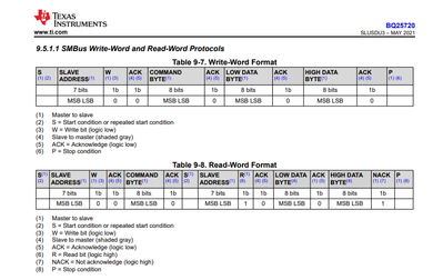

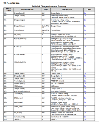

2.How to access various registers of the battery IC (BQ25720) using the SMBus protocol.
Could you help me?

‎2024-09-16 2:42 AM
This part below should be put in the HAL_SMBUS_MasterRxCpltCallback()
LOG_INFO("HAL_SMBUS_Master_Receive_IT:%d%d\r\n",buff[0],buff[1]);

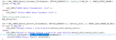

‎2024-09-19 8:13 AM - edited ‎2024-09-19 8:37 AM
Hello @PSR1
Could you please try the code snippet below?
// Define the BQ25720 device address and register address
#define BQ25720_ADDR 0x09
#define CMD_ID 0xFF
uint8_t device_id[2];
SMBUS_HandleTypeDef hsmbus1;
HAL_StatusTypeDef ret;
// Send the register address
ret =HAL_SMBUS_Master_Transmit_IT(&hsmbus1, (BQ25720_ADDR << 1), (uint8_t*)CMD_ID , 1, SMBUS_FIRST_FRAME);
if (ret != HAL_OK) {
// Transmission Error
Error_Handler();
// Read the Device ID from the Master TX complete call back
ret = HAL_SMBUS_Master_Receive_IT(&hsmbus1, (BQ25720_ADDR << 1), &device_id[0], 2, SMBUS_LAST_FRAME_NO_PEC);
// Reception Error
Error_Handler();
Could you help me?
The process is mentioned on the device datasheet.

‎2024-09-19 11:13 PM
Hello @Saket_Om ,
Thank you for the insight. I tried the aforementioned snippet. Could you possibly review my code and log?
Could you kindly assist me develop?
Thanks,
