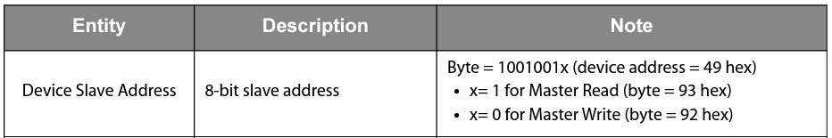

@Andreas Bolsch​ so, in this case I'm gonna shift the address 0x49 to the left and forget about the "x" ? I've got a 7+1 address sensor.0693W00000WKo0nQAD.png
Correct, you use 0x92, and the I2C peripheral controller deals with the -R/W bit based on the interaction you're engaging in.
You can tell if something is on the bus because it will ACK to it's address.
