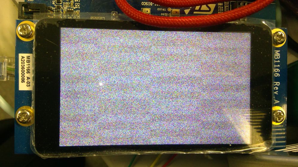

I want to use TouchGFX with AzureRTOS(Thread X).
※board is STM32F769DISCO
※TouchGFX Version is 4.16.0
I made stm32CubeIDE's project with TouchGFXDesigner.
(selecting board→making Screen→Gnerate Code)
I opened this project with STM32CubeIDE.

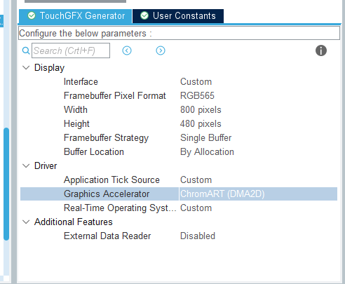

Next, I disabled FREERRTOS and set X-CUBE-TOUCHGFX.0693W000008zkhAQAQ.pngAfter that, I imported and refered some files related to ThreadX.
Next, I added some code refering to azure rtos's page in touchgfx guide,
and I write "hal.taskEntry();" in touchgfx_taskEntry() function.
I tried to run this project. The result is as follows.

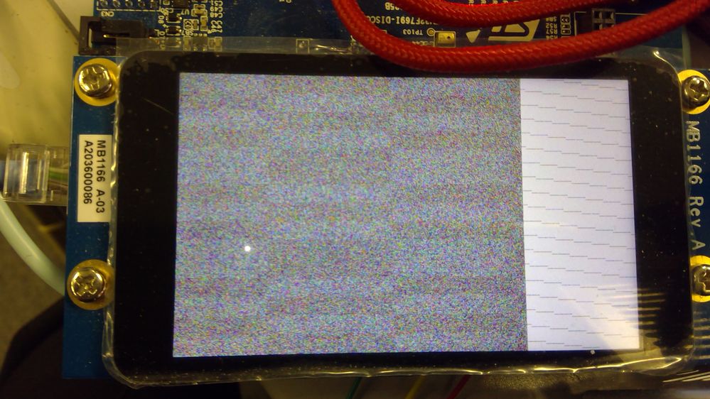

0693W000008zksNQAQ.jpgBut, when I enabled breakpoint in "OSWrappers::waitForVsinc()"in TouchGFXHAL::taskEnry() and debugged this project,
0693W000008zkyBQAQ.jpgI pushed resume button sometimes.

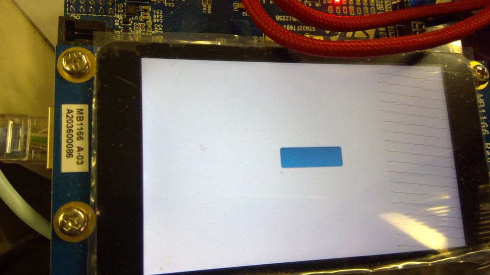

0693W000008zkz4QAA.jpgThis picure is my expected screen.
I don't understand why this ​phenomenon occurs nor what I should do.
