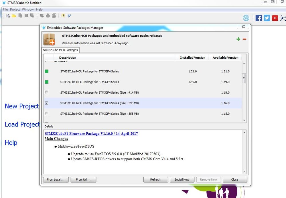

Hello @Mary West​ ,
You can find previous versions of STM32Cube firmaware package under STM32CubeMx tool:
Select Help > Manage embedded software packages.
Best Regards,
Imen.
