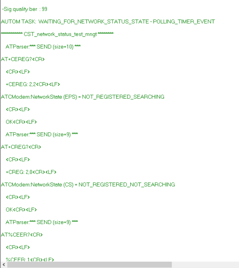

I need help with an issue regarding STM32L462RE (BL462ECELL1). How do you connect the modem to a network? I have been trying to use X-CUBE-CELLULAR. I flashed the binaries and know I can get some info from the modem, however i can't connect to the network
SPere.2

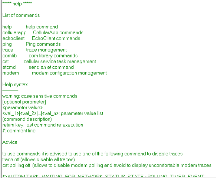

0693W00000FCgmbQAD.png0693W00000FCgsTQAT.pngIt keeps sending itself at commands and not connecting to the network.

Dear Andres,
This products works only on LTE-M or NB-IoT network and does not support 2G. Were you able to connect to enable the Truphone SIM subscription to test the "default" binary that is programmed in the device?
