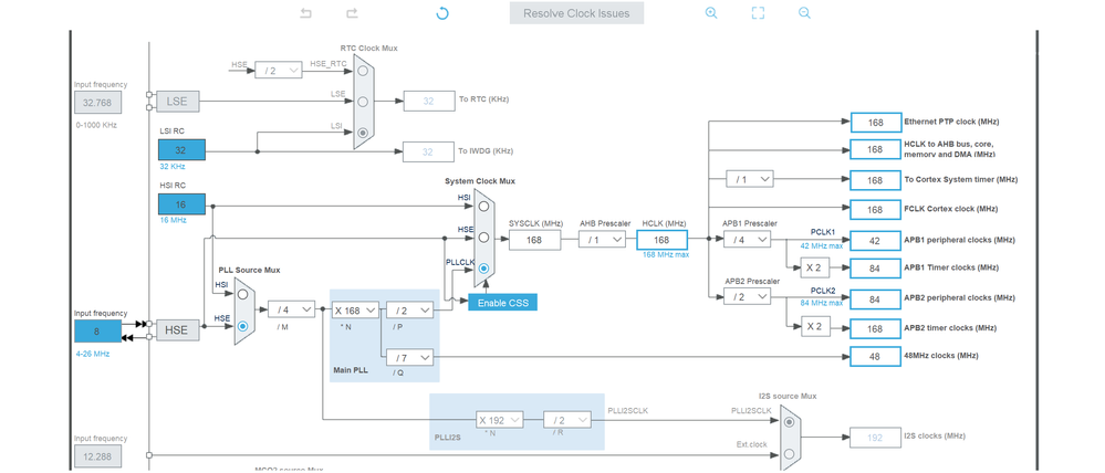

I am working with STM32F407 to write a text file to Pendrive (USB Host). But i am getting FD_DISC_ERR. When I debugged more i understood that this is due to HOST_DEV_WAIT_FOR_ATTACHMENT issue. Can anyone help why this is happening?

These are the pinout and clock config diagram
I am working with STM32F407 to write a text file to Pen drive (USB Host).
f_open(&MyFile, "testfile.txt", FA_CREATE_ALWAYS | FA_WRITE);

Hello @Ajithkumar​ and welcome to the Community :)
Try ClockDiv with 2 or 4.

Not worked. I tried with multiple clock vales.
I tried with example project in CudeIDE as well as i created new project from scratch but not worked me both.
Is any Size limitation for Flash Drive size ?
I mean I tried with 16GB and 32GB Flash Drive
