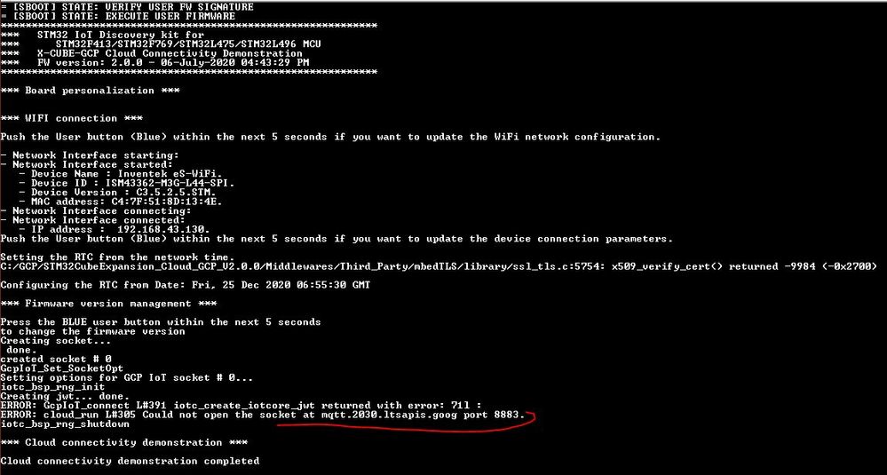

I am trying to make X-CUBE-GCP working but till now there is no any sign of success. The major issues I am facing is with mqtt connection not being established.
PDutt.2
0693W000006GtgDQAS.jpgAs shown above, the error is coming after jwt is created successfully. I checked the default mqtt hostname is not working with my sample python code.

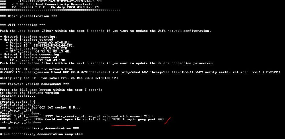

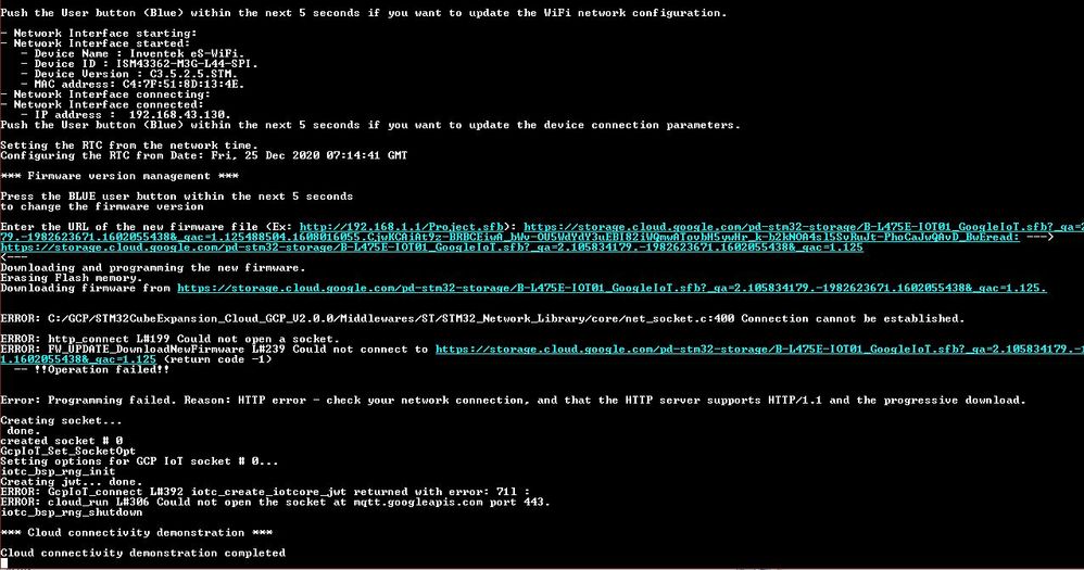

I changed the hostname to mqtt.googleapis.com and port number but still facing same issue.0693W000006GtgIQAS.jpgAs suggested in documentation, I thought the problem is with firmware and tried to updated the firmware with gcp storage account. But there is no success updating the firmware-0693W000006GtgNQAS.jpg
Please suggest whether there are any missing steps. I need to make this quickstart demo working before I can start the actual development. Thanks

If you readback the log, you will see that the JWT was not created properly - error 711. There are several reasons for this, but mostly are from user side. For me I was entering the wrong private key.
