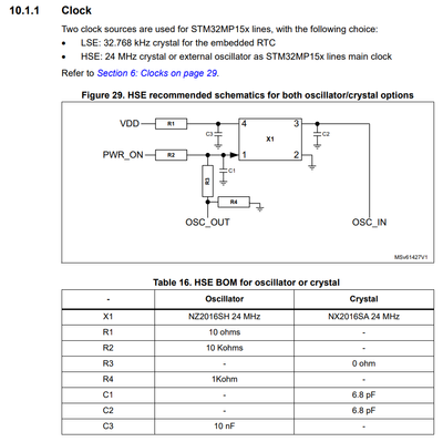

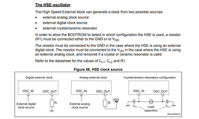

Regarding STM32MP153 advanced Arm<Sup>®</Sup>-based 32-bit MPUs - Reference manual point 10.4.2 HSE Oscillator.
Our hypothesis was that ROM Code failed to configure HSE Bypass because a 1K Ohm impedance was required to be connected to Vdd or GND in PH1-OSC_OUT pin.
This information is also specified in Getting started with STM32MP151, STM32MP153 and STM32MP157 line hardware development - Application note point 6.1.1
There is another key point. It may be mandatory to give the processor the capability to turn on/off HSE clock.
At point 10.1.1 of the same document (related to clock configuration)
