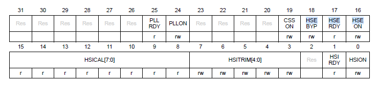

‎2020-11-05 6:56 AM
based on your advice "are you able to connect using SWD to your board running in bootloader (connect to running target) and read out PLL setting done by system DFU bootloader.", did some tests and here is what I retrieved :
* On the discovery, working DFU bootloader over USB, register RCC_CR reads 0x030b5783. Not sure how and why it detects an HSE as crystal is not mounted ...
* On my board, DFU bootloader running allow for UART bootload ! It confirms the bootloader is working but most probably does not detect the clock correctly.
* On my board, DFU bootloader running but no working USB, RCC_CR is 0x03004b83. Meaning that HSE is off as well as the bypass. Probably the bootloader does not detect a crystal and continues on HSI instead.
* On my board, if I change RCC_CR from 0x03004b83 to 0x01054b83 in the debugger (setting HSE on, bypass on), it ends up with 0x03074b83 (meaning the HSE turns to ready). It confirms that when bypass is enabled the HSE is correctly detected and set to ready.
* On my board, resetting the chip does not fix the issue, so it is not a race condition on external clock power on.
So if my analysis is correct the bootloader indeed does not enable USB because it runs on HSI instead of HSE bypass (not supported ?). Can you confirm my analysis ? Any way of forcing it to HSE with bypass or it is 100% boot rom without possible forced configuration ?
Thanks a lot.

On STM32F3 discovery HSE from STlink is connected also to target STM32F3 using SB12, so HSE can be used and detected by bootloader on discovery as well.
If you take a look into AN2606, you can see only UART interfaces are able to work without HSE, for USB HSE is mandatory.
Please be careful, that when UART is detected before USB in system bootloader, USB will be not initialized.
Regarding HSE, please check also RCC_CFGR register to read out, how PLL was set. From this setting it's visible, which HSE value was detected by system bootloader and if it's correct one.
Suggestion made by Jan to try also USB example in user application is also very good for testing. Using CubeMx you can create simple demo faster than reading out register content of system bootloader.
Please check USB training for guidance

Noted, but UART is not there in normal conditions, only tried to test as a workaround but my usb testing were performed without any UART connected.
RCC_CFGR is 0x0068040a. Meaning if i'm correct USBPRE = 1 = usb clock not divided and PLLMUL = 1010 = PLL input clock x 12 ... much too high for 24MHz input ... do you think it means HSE detection tries but failed ? HSE ON is off anyway in the end.
