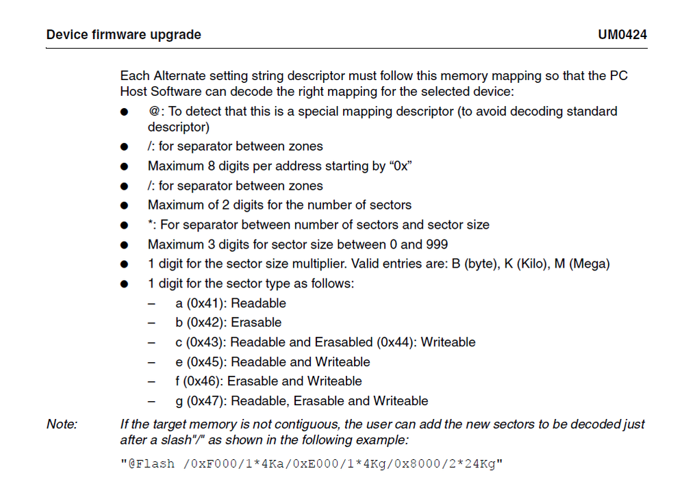

Posted on August 14, 2017 at 16:33
You can use our demonstrations examples  as a starting point and then you can customize with different Alternates.
By the way in your string descriptor,  do not forget to add the Units : Bytes, Kbytes, Mbytes etc. in this way :
 ''@Internal Flash   /0x08000000/120*128 a,1416*128 g''  MUST be
 ''@Internal Flash   /0x08000000/120*128Ba,1416*128Bg''  B to mean Bytes  and a '' Readable here is the definition in
http://www.st.com/content/ccc/resource/technical/document/user_manual/01/c6/32/df/79/ad/48/32/CD00158241.pdf/files/CD00158241.pdf/jcr:content/translations/en.CD00158241.pdf
Page 71/72
