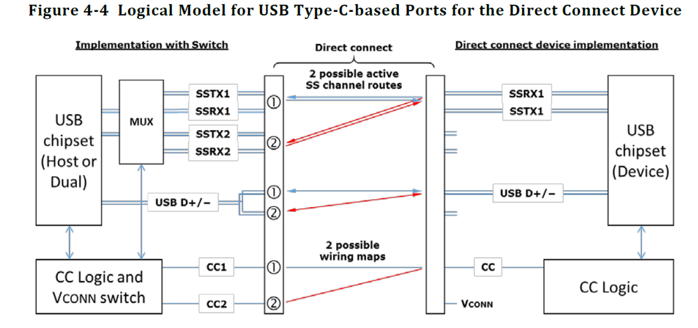

Hi every body, current we have a problem when make compatible between USB2.0 and type C on our devices.
We don't want full type C's feature yet. We just wanted our firmware to be compatible with type C cable on some laptop which have only type C connection.
So we pulled down 2 CC (CC1 and CC2) pin with 5.1Kohm. It likely work fine if we connected our devices to the laptop directly. But when we use Hub, the laptop doesn't recognize our devices.

Does that mean, no matter CC1 or CC2, only one CC pin needs to pull down, leave other one not connected? Because we are currently pull down both CC1 and CC2.
Also, ST says need 5.1Kohm resistor, any one know these value stand for?

Thanks a lot, that is clear. so both CC1 and CC2 need to pull down 5.1K which what we have. Not sure why it doesn't work if connect through hub

From USB C specifications:
For the device, the location of the USB SuperSpeed data bus, USB 2.0 data bus, CC and VCONN pins are fixed by design. Given that the device pin locations are fixed, only two possible connected states exist when viewed by the host.
In the case of a USB 2.0 device, using a USB Type C connector only CC1 must be connected to the pull down resistor. VCONN (CC2) can be left floating.

Hello @paolo239955_stm1_stmicro_com​
No you must drive both CC pins with one different Rd pull down resistor. Because you don't know how the cable will be plugged. And in case of EMC (Electonically Marked Cable) only one CC line is going from one end to the other.
