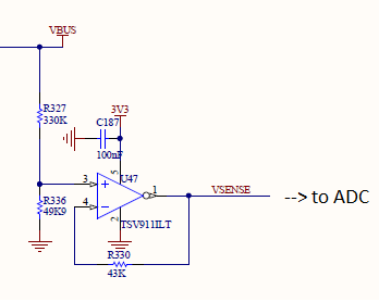

on G4 nucleo with STM32GG431RB, there is no Type C receptacle. How can you measure VBUS level ?
If you look on the other G4 boards with Type C we use voltage dividers and ADC.
On STM32G474E-EVALfor example, ADC2_IN6 on PC0 pin is used for VBUS level detection (VSENSE)
