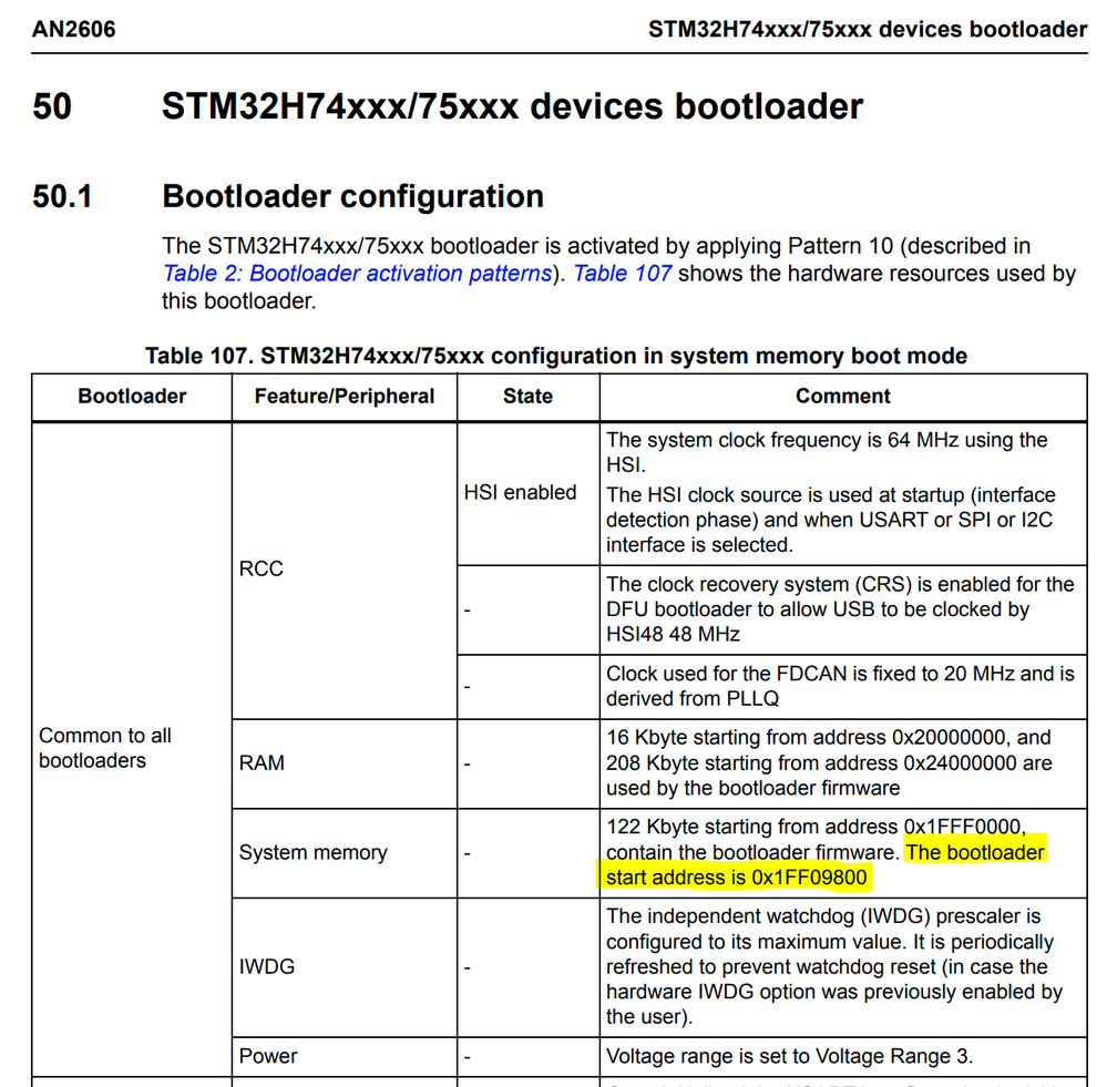

Also, I don't understand the claim in that article that the bootloader starts at address 0x1FF09800 when the documentation says it starts at 0x1FFF0000 (see AN2606). In any case, I tried jumping to 0x1FFF0000 and got a hardfault, so 0x1FFF0000 seems like the wrong address.

It's in AN2606.
2022-03-02 9:10 AM
Thank you very much! Not sure how I missed it.

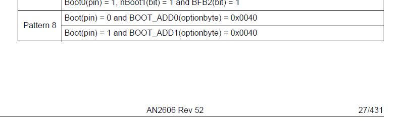

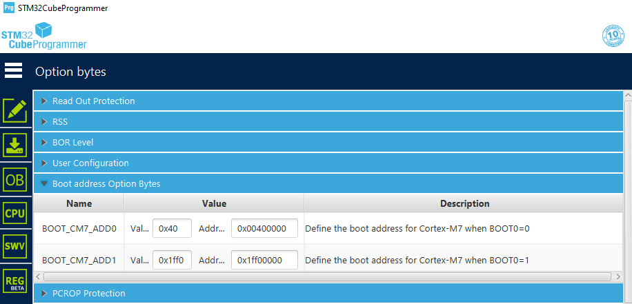

I can open another topic, but I can't seem to get into the bootloader on reset using pattern 8. BOOT0 is pulled low and with STM32CubeProgrammer I set BOOT_ADD0 to 0x0040.

@Khouloud GARSI
Please could you explain, how can the base address of system memory be 0x1FFF0000 and entry point of the bootloader be 0x1FF09800, shouldn't the entry point of the bootloader be in the system memory range? Isn't base address of system memory supposed to be 0x1FF0 0000? Reference manual RM0468 for STM32H72/STM32H73 (Table 6 in section 2.3.2) also suggests that this is the base address (but there is for a change specified wrong end memory of the range - 0x1FEFFFFF, which is one byte lower than the supposed start address).
2024-05-12 4:49 PM
Hi @heveskar ,
You are absolutely right, the system memory address is wrong in the revision of AN2606 that is shown in the previous reply. In AN2606 revision 62 page 269, section 53.1, we can see the same table, with the corrected address:
System memory - 122 Kbytes, starting from address 0x1FF00000 contain the bootloader firmware. The bootloader start address is 0x1FF09800
For anyone landing here, I recommend the following article, where we can see a working bootloader jump code that works in almost all STM32 chips. The exceptions are the chips with "empty check mechanism".
Regards.
