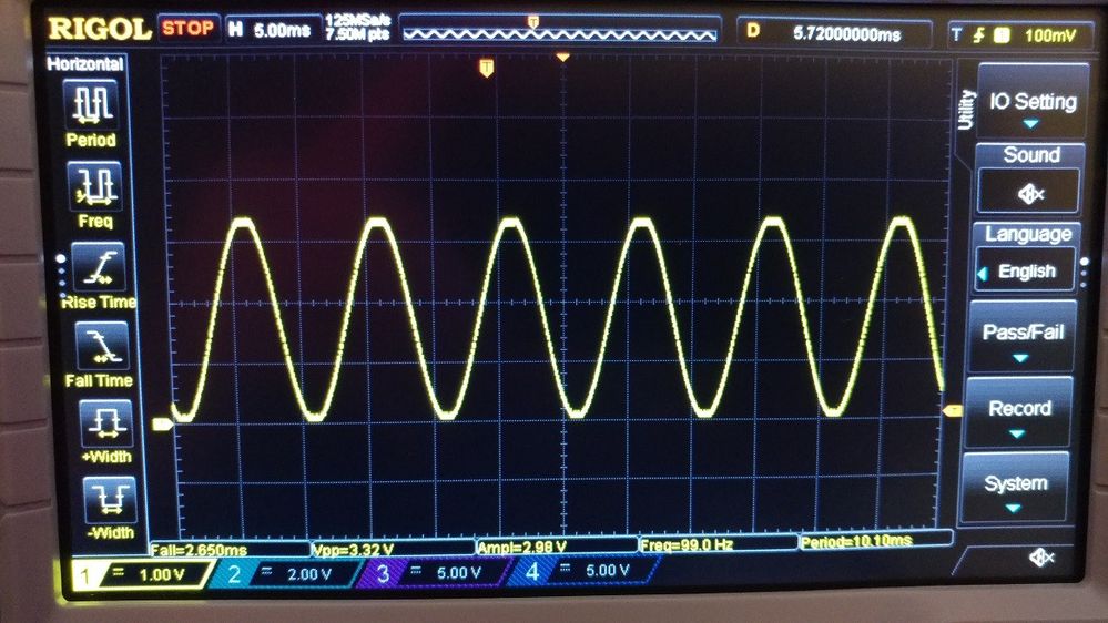

I have the code I used to generate the sine wave according to the doc along with my scope pic

The clock for TIM6 is at 80Mhz. The prescalar is 80-1, the period is 100-1, and the #samples is 100. So 80Mhz/(80 * 100 * 100) = 100Hz.
Here is the picture of the sine wave I generated at 100 Hz

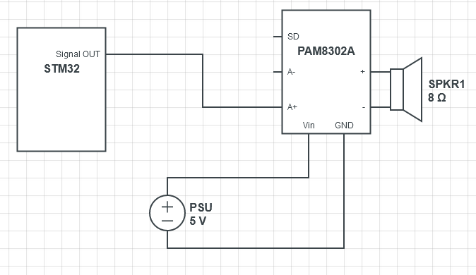

Here is a image of the schematic.0693W00000AOxYAQA1.pngI hope you can help out. Thanks

> I plan to output the audio to a PAM8302a amplifier which is connected to a speaker. I was following along with the AN3126 (Waveform generation using DAC). I was able to successfully generate waveforms and view them on my oscilloscope. But when I send audio data, it's just static.
Sounds reasonable.
But take the DAC output impedance into account.
In unbuffered mode, this is about 1 MOhm, which is most probably not enough to drive the amplifier.
The PAM8302 datasheet does not specify an input impedance, but try to enable the "BUFFERED" mode of the DAC, with 15kOhm output impedance.
And, I think you are not supposed to leave the A- input pin unconnected.
TC2
Hi. Thanks for the response. I should mention the sine wave was able to produce an audible tone.
I forgot to mention it is already in buffered mode. You are right, I shouldn't have left A- floating, I connected it to GND as it's ground or a 2nd output line which I don't have in this case. It basically just made the speaker louder.
