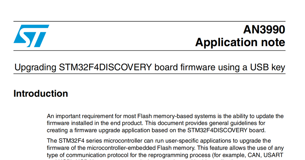

Dear All:
I want to know if have source code about the upgrade firmware on STM32F4DISCOVERY?
Thanks!

It was in the SPL package for the F4 Discovery. Might be an equivalent in the CubeF4 repository for the board also.
2019-11-01 6:02 AM
STM32Cube_FW_F4_V1.24.0\Projects\STM32F4-Discovery\Applications\FatFs\FatFs_USBDisk\readme.txt
https://www.st.com/en/embedded-software/stsw-stm32068.html
en.stsw-stm32068.zip\STM32F4-Discovery_FW_V1.1.0\Project\FW_upgrade
