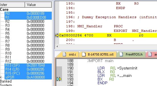

I downloaded amason freertos source code from github site below.
https://github.com/aws/amazon-freertos
and there was no problem when i worked on AC6 IDE.
because enviroment file is included in source code.
but when i created uVision project by myself. it didn't work.
it stopped at hardfault like below.
if possible, I want to convert .ld file into .sct file.
but i am not get used to both file format.
please refer to attached file.
as for a reference.. I have already generated project file including Freertos for uVision 5 on CubeMx. but failed..

Jpark.1
another comment :
First execution was run well after building and loading, there was no problem.
and then click "RST" button on uVision IDE.
when i run it second times, it goes into hardfault_handler..
Jpark.1
I have solved this problem.
it's memory allocation error in scatter loader file.
I allocated UNINIT_FIXED_LOC section into external memory
I finally got to know the error debugging flash write execution.
>> before modification
LR_IROM1 0x08000000 0x00100000 {  ; load region size_region
 ER_IROM1 0x08000000 0x00074000 { ; load address = execution address
LR_uninit_fixed_loc 0x08074000 0x3000 { ; it's external memory allocation.
 ER_uninit_fixed_loc 0x08074000 0x3000 {
  .ANY (UNINIT_FIXED_LOC)
>> after modification
  *.o (RESET, +First)
  *(InRoot$$Sections)
  .ANY (+RO)
 ER_uninit_fixed_loc 0x08074000 0x3000 { it's internal memory allocation.
 ZI_IRAM1 0x20000000 0x00018000 { ; ZI data
  .ANY (+ZI)
 RW_IRAM1 0x10000000 0x00008000 { ; RW data
  .ANY (+RW)
  .ANY (.freertos_heap2)
