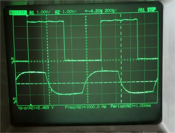

Its working like this:
void HAL_ADC_ConvCpltCallback(ADC_HandleTypeDef *hadc)
if (hadc->Instance == ADC1)
ADC1_Read();
and in the ADC1_Read function I start the DMA again, its running now without problem, trigger source is OC event from Timer4, the GPIO toggle was to check the time when ADC conversion is finished
void ADC1_Read (void)
ADC_Niveau.BoilerLow = ADC_Values[0];
ADC_Niveau.BoilerHigh = ADC_Values[1];
ADC_Niveau.TankHigh = ADC_Values[2];
ADC_Niveau.TankUeberlauf = ADC_Values[3];
//eud Test
HAL_GPIO_TogglePin (Error_Reset_1_GPIO_Port, Error_Reset_1_Pin);
HAL_ADC_Start_DMA(&hadc1, (uint32_t*)ADC_Values, 4);
Trigger for the ADC Event = CH1, CH2 = ADC to measure
