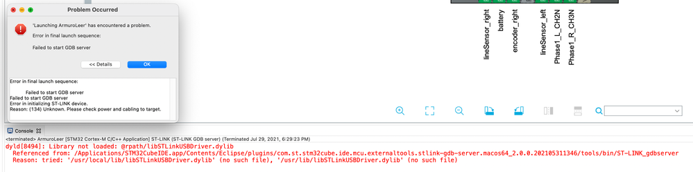

I am currently working on a university project and we are using the STM32L432KCUx. When I connect my roboter via mini USB with my MacBook and build it, I get no errors. If I try to run it, however, I get an error message (see attached screenshot).

Hello @LProb.1 ,
Take a look at this link : https://stackoverflow.com/questions/61106861/how-can-i-start-the-gdb-server-in-stm32cubeide
This can help you to solve your problem.
