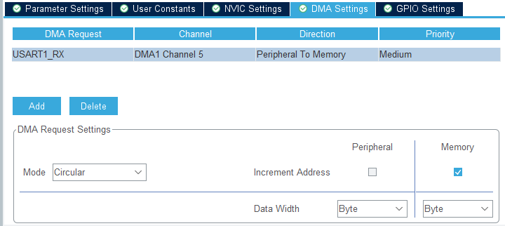

I am working on STM32F1 family and implementing LIN communication. I found the function HAL_UARTEx_ReceiveToIdle_DMA() that is very useful to handle variable incoming data.

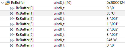

But I have a problem that this function only works first time, but not calling HAL_UARTEx_RxEventCallback(), I need to get data in USART1_IRQHandler() function. The reason is because the flag of Frame Error is arrising and stops the receive DMA process. The intersting is that the received data is correct, for all different RX size.
I review all init and functions according to the examples and forum, and it seems ok.  Could it be because the link break detection? My RX buffer always show zero as the first byte, so it compute the break as first data.
byte[0] = break;
byte[1] = sync;
byte[2] = PID...
DMA init
static void MX_DMA_Init(void)
 /* DMA controller clock enable */
 __HAL_RCC_DMA1_CLK_ENABLE();
 /* DMA interrupt init */
 /* DMA1_Channel5_IRQn interrupt configuration */
 HAL_NVIC_SetPriority(DMA1_Channel5_IRQn, 0, 0);
 HAL_NVIC_EnableIRQ(DMA1_Channel5_IRQn);
Start receive process:
 if (HAL_OK != HAL_UARTEx_ReceiveToIdle_DMA(&huart1, pdata, 20))
	 Error_Handler();

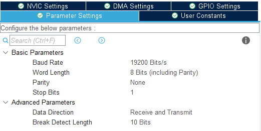

Lin Config:
DMA config:

If frame error bit is set, there's probably a frame error in the data.
Perhaps the line is not properly pulled up prior to initialization. Can you view the signal on a scope? What is sending the signal?
