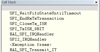

I have a problem with ''HAL_GetTick()'' that is blocking the SPI interrupt. In my program, I use the ''HAL_SPI_Transmit_IT'' function from STM32F0 HAL driver library to initiate a SPI transmission. After a while, a SPI interrupt occurs and the following functions are called: 0690X00000604sVQAQ.png In the last called function (''HAL_StatusTypeDef SPI_WaitFifoStateUntilTimeout'' function of ''STM32F0xx_HAL_Driver\Src\stm32f0xx_hal_spi.c'' file), the following instruction is blocking my program:
if
((Timeout == 0) || ((HAL_GetTick()-tickstart) >= Timeout))
The tick value is always the same (217) and the program can’t run out of this function until this condition is true. First, I put a breakpoint in function '' GetTick()'' (from '' STM32F0xx_HAL_Driver\Src\stm32f0xx_hal.c'' file but nothing happened: the function was never called. In the

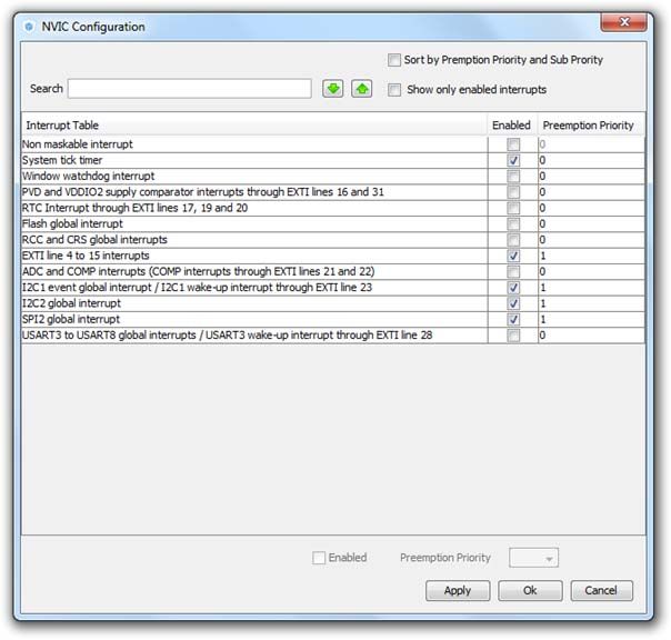

Following this note, I configured all the other interrupts with a lower priority in my STM32CubeMx project:
Unfortunately, this didn’t change anything.

One approach is not being reliant on counters that are incremented by interrupts. Then priority, and inversions, won't be an issue.
You'd probably want to double check the NVIC Group configurations, and that it's actually got the Preemption and Priority levels you think it has. Look at the registers, and the documentation, don't rely on the tool doing it properly.
