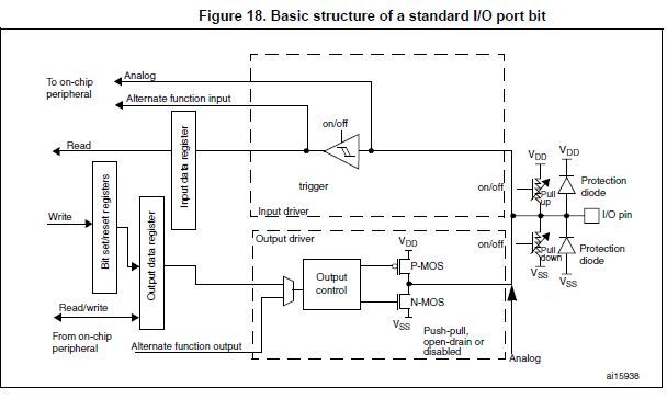

Might not be the best answer, to me the clock enable of GPIO port registers is like TIMER:
To write on the peripheral registers (for example MODER or AF) you will need these registers to have clock for read/write.
Otherwise, registers looks like read only and typically stuck to 0x0000 after reset.
By disabling GPIO's clock, GPIO functionality "freezes".
This means all registers preserve its values, also are not readable and return some predefined value such zeroes and can by modified by re-enabling the clock.
If an external pin configured as eg GPIO output PP and set it to HI, after disabling the clock the pin's state don't change.
So , external pins can be used as AF input or Analog modes with GPIO's clock disabled. (just configure AFRL,AFRH,MODER. etc registers appropriately before disable the clock)
