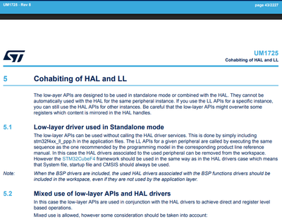

Normally we use HAL_GetTick() in HAL driver.
I want to use GetTick() in STM32 LL driver.
How to get and use GetTick() in STM32 LL driver?
1 REPLY 1
Andrew Neil
You can use both HAL and LL together in a project.
https://www.st.com/resource/en/user_manual/um1725-description-of-stm32f4-hal-and-lowlayer-drivers-stmicroelectronics.pdf#page=44
via: https://www.st.com/en/embedded-software/stm32cubef4.html#documentation
Or you could just look at how HAL_GetTick() works (the source is provided), and implement that yourself ...
