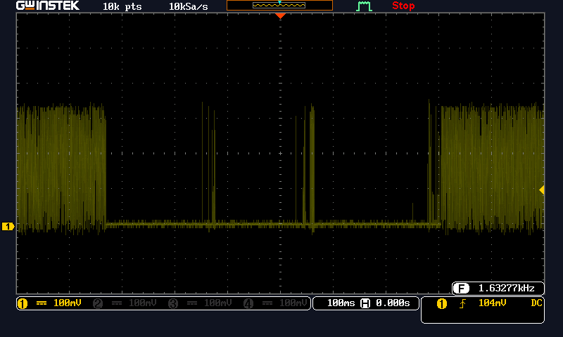

I'm trying to play a sound file with raw PCM data using the DAC:
uint8_t buffer[16384]; // 4-aligned
uint8_t *bufptr[2] = {buffer, buffer + sizeof(buffer) / 2};
int curr_buffer = 0;
volatile int audio_dma_half_complete = 0;
f_read(fh, buffer, sizeof(buffer), &br);
HAL_TIM_Base_Start(&htim6);
sConfig.DAC_Trigger = DAC_TRIGGER_T6_TRGO;
sConfig.DAC_OutputBuffer = DAC_OUTPUTBUFFER_ENABLE;
if (HAL_DAC_ConfigChannel(&hdac, &sConfig, DAC_CHANNEL_2) != HAL_OK)
return 1;
if (HAL_DAC_Start_DMA(&hdac, DAC_CHANNEL_2, (uint32_t *)buffer, file_size,
DAC_ALIGN_8B_R) != HAL_OK)
return 2;
while (1) {
while (!audio_dma_half_complete);
f_read(fh, bufptr[curr_buffer], sizeof(buffer) / 2, &br);
if (br == 0)
break;
curr_buffer = !curr_buffer; // toggle buffer half
HAL_TIM_Base_Stop(&htim6);
HAL_DAC_Stop_DMA(&hdac, DAC_CHANNEL_2);Note that the file contains raw PCM data that as already been reduced to 8 or 12 bits, resp.
This kind of works, but there are regular gaps of about 600 ms of silence, followed by 2-3 s of the signal.
While the signal itself makes me think I have an endianness problem, the main issue are the gaps. (This diagram shows a gap for 12R data; for byte data, the gaps are more than 1 second wide.)
My first explanation were underruns, but doubling the SDMMC speed had absolutely no effect.
The second explanation were external interrupts, which in theory should be regular but run very shortly. But disabling all EXTI interrupts had again no effect.
What else might cause these gaps? Is it a priority problem between different peripherals?
Solved! Go to Solution.

It may be related to the configuration of the DMA channel, is it well set to Circular mode ?
During the ‘gap’, it looks like data are send to the dac (the bursts at the center of the screen), the dma may be ‘free’ running at unexpected memory location.

2019-04-14 3:46 AM
Thanks for your suggestion. I didn't realize that the half interrupt will not trigger at the end of the buffer (that would make things much simpler).
Please note that generating audio from a fixed circular array (i.e., not using FatFs to load more data) works perfectly fine.
But I still don't understand the length parameter of HAL_DAC_Start_DMA(&hdac, DAC_CHANNEL_2, (uint32_t *)buffer, length, DAC_ALIGN_8B_R). If length is the total length of the data to send (like the declaration states), how does the HAL know how large the buffer is? Or is it the length of the buffer instead, and I have to detect the end of the data myself?
