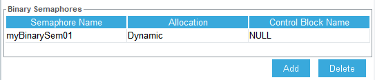

4. Enable FreeRTOS in the Middleware tab (CMSIS_V1) and add a single binary semaphore to the stack:

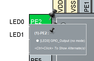

5. Set two pins as output for LEDs:

Now I can incorporate the semaphore code to the main thread:
void StartDefaultTask(void const * argument)
/* USER CODE BEGIN 5 */
/* Infinite loop */
for(;;)
HAL_GPIO_TogglePin(LED0_GPIO_Port, LED0_Pin);
if(osSemaphoreWait(myBinarySem01Handle, 5000) == osOK)
HAL_GPIO_TogglePin(LED1_GPIO_Port, LED1_Pin);
osDelay(100);
/* USER CODE END 5 */
and the periodic callback:
void HAL_TIM_PeriodElapsedCallback(TIM_HandleTypeDef *htim)
/* USER CODE BEGIN Callback 0 */
/* USER CODE END Callback 0 */
if (htim->Instance == TIM6) {
HAL_IncTick();
/* USER CODE BEGIN Callback 1 */
if ((HAL_GetTick() % 3000) == 0)
osSemaphoreRelease(myBinarySem01Handle);
/* USER CODE END Callback 1 */
Pretty much the whole idea is to release the semaphore from this instance.

Hi. Don`t call any FreeRTOS function when you in Timebase Interrupt Handler.
At "FreeRTOSConfig.h" you can find next:
/* The highest interrupt priority that can be used by any interrupt service
routine that makes calls to interrupt safe FreeRTOS API functions. DO NOT CALL
INTERRUPT SAFE FREERTOS API FUNCTIONS FROM ANY INTERRUPT THAT HAS A HIGHER
PRIORITY THAN THIS! (higher priorities are lower numeric values. */
#define configLIBRARY_MAX_SYSCALL_INTERRUPT_PRIORITY 5
Interrupt priority for timebase timer is 0 (highest priority).
For your project you can configure any other timer for interrupt generation with priority lower that configLIBRARY_MAX_SYSCALL_INTERRUPT_PRIORITY (ex. 6, 7 ...). And put Semaphore Release function to that interrupt handler.
