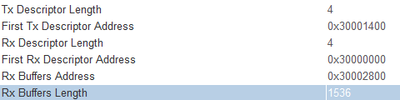

Correct me if iam wrong, each instance requires there own tx and rx descriptors for simultaneous communication minimum 96 bytes for each.

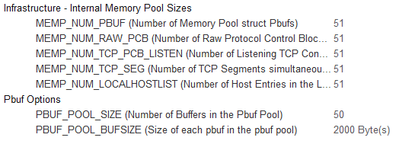

Pbuf is for handling all the incoming and outgoing data which highly depends on the number of bytes incoming
Rx pool i dont have a clear differenciation on this with Pbuf,

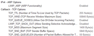

The configurations are based on the referance from the above link, and i have modified some parameters which thought necessary for increasing the number of instancs.

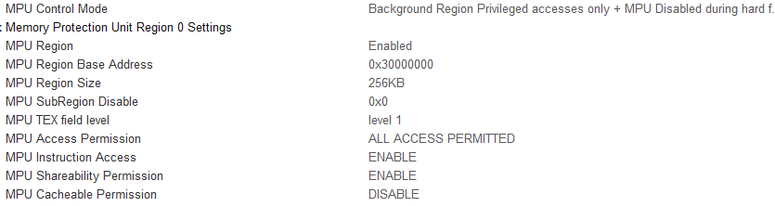

MPU configuration
Linker configuration
RAM_D2 (xrw) : ORIGIN = 0x30000000, LENGTH = 288K
.lwip_sec (NOLOAD) :
. = ABSOLUTE(0x30000000);
*(.RxDecripSection)
. = ABSOLUTE(0x30001400);
*(.TxDecripSection)
. = ABSOLUTE(0x30002800);
*(.Rx_PoolSection)
} >RAM_D2
I want to have have a clear understanding of the memory configuration parameters, if you have any answer/referarances I would appreciate your assistance.

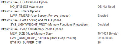

lwip heap memory size is the amount of memory allocated for the lwip stack to handle network data. It can be configured by the macro MEM_SIZE, which defines the size of the heap memory in bytes. The default value of MEM_SIZE is 1600 bytes, but it can be increased if the application sends a lot of data that needs to be copied. The heap memory can also be assigned to a specific region by using the macro LWIP_RAM_HEAP_POINTER, which points to the start address of the heap memory.

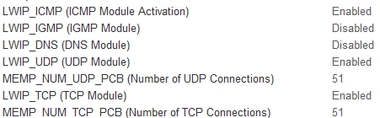

Each TCP PCB consumes a certain amount of memory. Increasing MEMP_NUM_TCP_PCB will directly increase the memory usage of the lwIP stack. This includes memory for the PCB structures themselves and associated buffers for data transmission and reception.
lwIP uses memory pools for various structures, including PCBs. Increasing the number of PCBs will require larger memory pools, which can lead to higher static memory allocation.
to summarize memory usage with Ethernet is divided by DMA descriptors and Tx/Rx buffers followed by the Lwip Heap which may vary in size but needs to respect your physical memory boundaries and RAM sizes ...

I have done some digging and understood that
Descriptor Size :
RX Pool Configuration:
TX Data :
PBUF :
Memory Required For a single SOCKET is 156 bytes (tcp_pcb variable)
Amount of memmory required for a single client/server is= TX descriptor(fixed)+Rx descriptor(fixed)+socket size(fixed)+TXPbuf(variable)+RXPbuf
Here I am assuming a payload size of 110 bytes for transmitting and reception
96+96+156+110+110= 568 bytes
