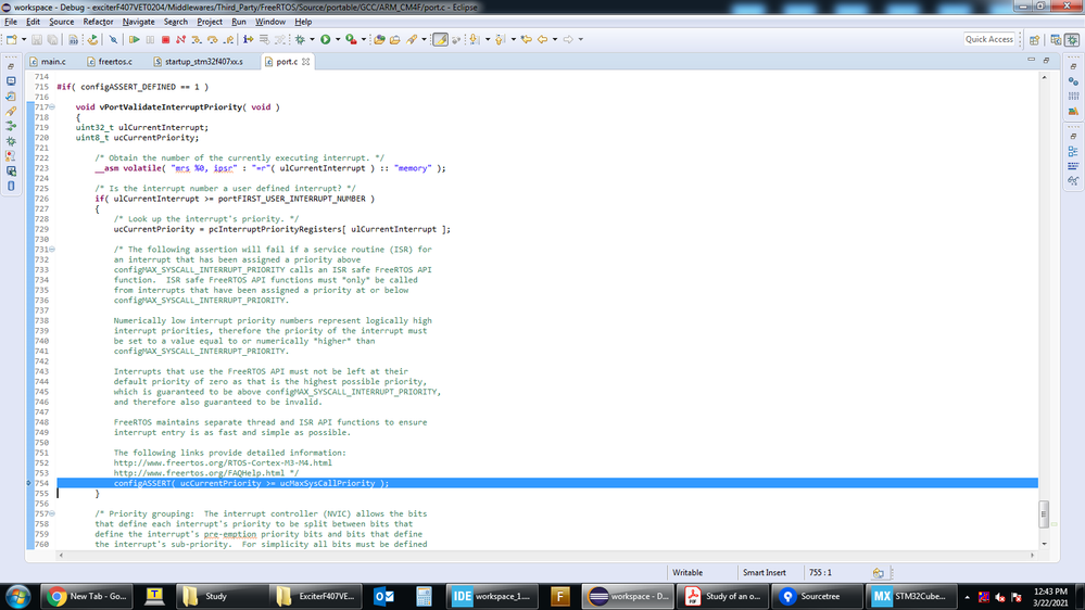

I am trying to confgiure LwIP on STM32F407VET with Firmware version
STM32Cube FW_F4 V1.25.0
I am using SWSTM32 as IDE, and configuring hardware on STM32CubeMX 6.0.1
I am not able to configure LwIP, as the code gets stuck in ASSERT statement as shown in the following image randomly.
Please help me to run FreeRTOS with Ethernet seamlessly

The problem explanation is literally in front of you! Read the code comments in that same screenshot you posted.
