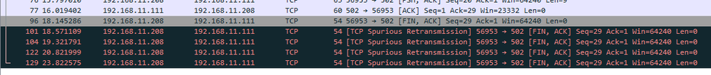

0690X000006CsADQA0.pngSo I modificate my receive funciton, and now I close connection and program don't crash.
if (p == NULL)

But connection is bad closed.
