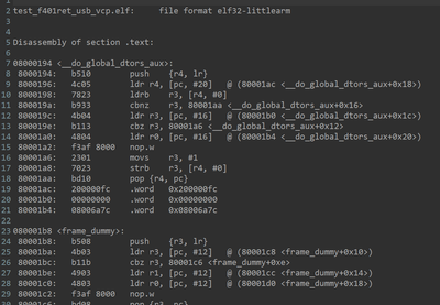

I want to compare a couple of different ways to implement the same functionality in an ISR to see which one leads to the smallest/fastest code.
Is there a way - after compiling but without running a debug session - to see the disassembly code after each instruction?

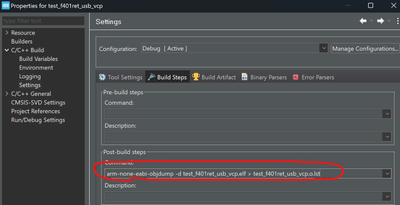

Add a post-build step to create the listing file:
After building, you can then open this file to view the disassembly.
