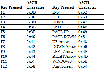

currently otg keyboard working fine and getting all the character but i want hex code of function keys f1 to f9 . now i am getting only zero for f1 to f9 keys .can you show exactly where i need to map f1 to f9 keys equl hex codes in usb_hid_keybd.c

0693W00000YAsi8QAD.pngwhere to insert above value ascii code in usb_hid_keybd.c above mentioned
