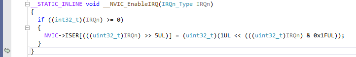

Controller stalls at NVIC_EnableIRQ(CAN_TX_IRQn) after jump to application from a bootloader.
MGand.1
I am using a CAN bootloader to update my application. But after flashing the application and jumping from the bootloader to the reset vector of the app, the program stalls after calling NVIC_EnableIRQ(CAN_TX_IRQn). Is there a problem that the bootloader already used the CAN peripheral?

Update:
I looks like the application calls the old interrupt routine address of the bootloader
 .text.TgtCAN1TXIsr
                0x08009be8        0xc VisualGDB/Debug/target.o
                0x08009be8                TgtCAN1TXIsr
Make sure you correctly configure the Vector Table, via SCB->VTOR, typically in SystemInit()

MGand.1
Before the jump to the application the bootloader set stack pointer and the vtor pointer, after the start of the application the
SystemInit overrides with the old flash start value 0x08000000.
> ... after the start of the application the SystemInit overrides with the old flash start value 0x08000000.
Then you might need to adapt your application / SystemInit.
Both bootloader and application are supposed to harmonize in this regard.
That would be because you haven't accounted for.the change in location. ST has coded this poorly, code it better.​ The use of a linker fixed symbol would make the code agnostic.
Thank you, I have know added an additional variable that sets the flash origin in my linker script and SystemInit uses this variable to define VTOR.
