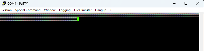

At the moment I'm working on a project using the STM32F4 discovery board that combines CAN2 and USART2. I managed to get them both working separately, but when I combine them in the same problem I get weird output on the serial monitor. When I then try my old program to only test the UART connection it works fine. Any ideas on why the combination of CAN and UART isn't working?

The serial output:
Javier1
Principal
Are you Reseting the canbus every time you run CAN_Polling() by any chance, if this is true ,why?
