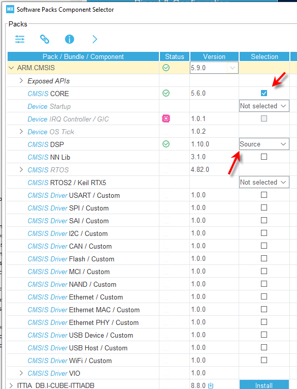

I just started a new project and wanted to use CMSIS 5.9 - as it finally can be installed from the package without errors.
Until now I only used CMSIS 5.7 als library, which worked pretty well. Unfortunately since 5.9 there is no library availiable, which could be included so I had to select "source" in the CubeMX Setup:
CubeMX CMSIS SetupCubeMX CMSIS Setup
The only difference to CMSIS 5.7 as I used it previously is, that I selected "source" for the DSP component and of course the version 5.9

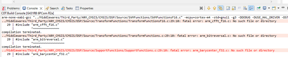

I wrote a simple test programm and tried to compile it. The result is a lot of missing dependencies:
console outputconsole output
it is e.g. complaining about:
./Middlewares/Third_Party/ARM_CMSIS/CMSIS/DSP/Source/SupportFunctions/SupportFunctions.c:29:10: fatal error: arm_barycenter_f32.c: No such file or directory
or
../Middlewares/Third_Party/ARM_CMSIS/CMSIS/DSP/Source/SupportFunctions/SupportFunctionsF16.c:29:10: fatal error: arm_copy_f16.c: No such file or directory

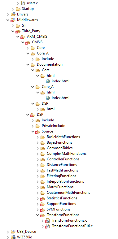

project treeproject tree

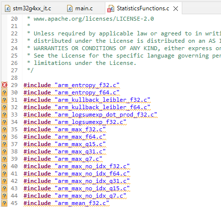

if I open one of these files, it is just the tip of the iceberg, there are lots of missing dependencies:
StatisticsFunctions.c e.g. wants to include lots of *.c files, which are non existant in the project.
I have added ../Middlewares/Thrid_Party/ARM_CMSIS/CMSIS to the incude directories in the Project setup, with no result - which is obvious because the included files do not exist in the project folder.
Where can I find the missing files?
Do I have to manually downlowad CMSIS 5.9 and copy it into the "CMSIS" folder of the project? Or something like that? It's obvious that there is something at the lowest level, but I have no experience at all with including the CMSIS sources and I have no idea where to start my search.
Can anyone point me in the right direction?
By the way: if I select CMSIS in the CubeMX Project Setup, it automatically creates a link to the source folder "CMSIS" in the project path, but the folder is not created. So at the first start of a project with CMSIS a problem notification pops up. My solution so far was to create an empty folder named CMSIS, then the problem notification disappeared. Does this eventually mean CubeMX / CubeIDE expects me to add my version of CMSIS manually to the project? I'd expect that CubeMX would do this automatically, if I select CMSIS Base and DPS in the Setup. But you never know ...
