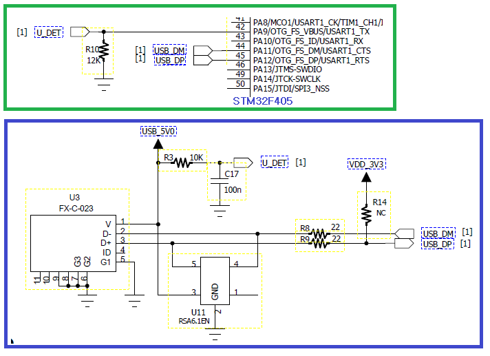

I'm using the STM32CubeMX 4.3.0 version.I created a project for CDC Virtual COM port for STM32F405RG micro. I need full duplex communication. Please find the attached CubeMX project .ioc file.
Following is the USB schematic of the board. 0690X000006058ZQAQ.png Generated code for IAR EWARM. The generated code has the following functions to receive & transmit data.

I have changed a line in
CDC_Transmit_FS
function to use it from main.c file to write data to USB. How can I get data out of
UserRxBufferFS
buffer as there is no code inside
CDC_Receive_FS
function ? In my application, I need full duplex USB communication. Please through some code samples for this project. I have seen CDC_Standalone example in STM32Cube_FW_F4_V1.3.0\Projects\STM324x9I_EVAL\Applications\USB_Device\CDC_Standalone But this is quite different from what I want to achieve ( this is USB to RS232 bridge sample) #virtual-com-port #cdc #stm32f4
