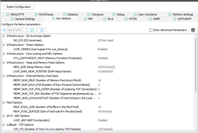

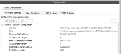

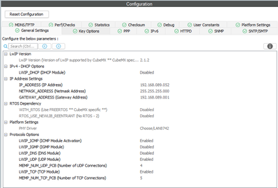

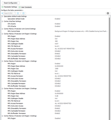

  •  ETH conf in CubeMX: DavidWahlberg_0-1716890710911.png
  • MPU conf in CubeMX:DavidWahlberg_1-1716890788039.png
  • LWIP conf in CubeMX:DavidWahlberg_2-1716890822375.pngDavidWahlberg_3-1716890840980.png
Any suggestions?

Best answer by STea
Hello @DavidWahlberg ,
I recommend you check the following Example STM32Cube_FW_H7_V1.11.0\Projects\NUCLEO-H723ZG\Applications\LwIP\LwIP_TCP_Echo_Server\ as a reference because at first glance you are missing some necessary steps and the MPU config as well is not in line with the example.
BR
