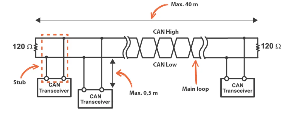

Hello everyone. I use STM32F4 to transmit CANBUS messages. When i connect Can High and Can Low lines to CAN-USB transformer i see messages coming to computer but after a short while the communication between MCU and computer stops. If i reset the MCU, message flows restarts but the same problem occurs again.
Has anyone encountered and solved such a problem?

Hello. Is it possible to show your code ?
AScha.3
>Has anyone encountered and solved such a problem?<
jepp. do you have termination resitors on both line ends ?
-> if errors -> If the "transmit error counter" is above 255, the CAN interface transitions into this state.
https://knowledge.ni.com/KnowledgeArticleDetails?id=kA00Z000000kGnGSAU

Hello AScha,
I have ended can high and can low terminals with 120Ohm resistor. High and low terminals were connected to can usb tranciever.
So, you mean i must add one more 120Ohm resistor?
Thank you.
0693W00000aJhBTQA0.pngone 120r on each end . check the can/usb adapter to have a resistor - if not, try and add one there also.
Actually, now it is working well. But i deconnect the usb from one computer and connect the other computer (same can-usb interface exists each computer) the problem i mentioned occurs. It is interesting.
In this context, is it necessary to reset the can communication in the software?
you should make some error handling -> reset/restart ...
https://www.csselectronics.com/pages/can-bus-errors-intro-tutorial
Thanks, by the way. I notice that the reason of the problem was about EMI. When i do shielding correctly, the problem was solved.
