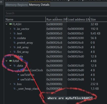

i am trying to make a bootloader for a stm32f030k6t6, i was reading the AN4325 application note, from what i understood that i can only have a USART bootloader on pins PA14/PA15 or PA9/PA10, and i have a bluetooth connected on the uart1 serial which are different pins from PA14/PA15--PA9/PA10, i wanted to know if it is possible to use the bluetooth to make OTA bottloader. and also I have many doubts about the RAM memory, since it is 4k, it starts at address 0x2000 0000, then I must make a division of memory for the bottloader initially I am placing 0x200100, I do not know if it is right to define that amount.

jdo
in the linker, i write:
.myBufBlockRAM 0x200100:
KEEP(*(myBufSectionkRAM)) /* MANTIENE MI VARIABLE SIEMPRE QUE NO ES REFERENCIADA */
}>RAM

jdo
jdo

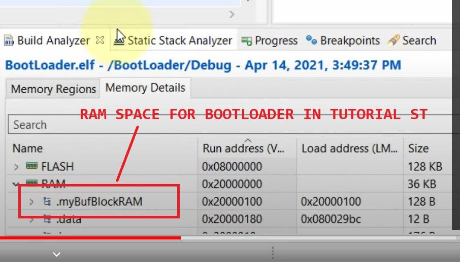

Not sure why you need to allocate a buffer in that way, but surely needs to be 0x20000100 not 0x200100​
jdo
I AM DOING THIS TUTORIAL ST: (332) How to Create a Super Simple Bootloader, Part 1: Getting Started - YouTube,
What way do you recommend to make a simple bootloader?
how do I determine how many bytes there are from 0x2000 0000 to 0x20000100?
I'm sorry for my ignorance, I'm not an expert in stm32, some time ago I programmed in c with microchip, but I'm programming a board with stm32, and I like to discover.
jdo
0693W00000NsyAQQAZ.jpgin the tutorial st youtube i view this
I'm not sure this stuff is super STM32 specific. This is compilers, assemblers, linkers and loaders
Man that video is painful. Often it's better to use a robot to narrate a script.
Why's he put a section smack in the middle of his loader, loader 12KB, dumps stuff at 4K (0x1000)
Used, or physically?
0x100 -> 256 bytes
Still it says 0x20000100, not 0x200100. The basis of RAM in Cortex-Mx parts is 0x20000000, FLASH 0x08000000
He's allocating space for variables/structures you want in common between the two.
You could advance the basis of RAM in the linker script, and use a structure via a pointer.
Are you sharing a lot of information between the two? Usually apps are free standing, and the loader basically just needs to validate them, and provide a means/method of updating or disaster recovery.
