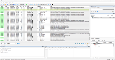

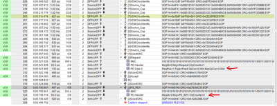

Meanwhile I've been making some small successes but I'm still faced with issues/questions.
FYI I'm adding PD packet traces taken with a CC line bus sniffer.
First thing I noticed is that it takes the SINK ST USPD stack a long time before it start replying to the SOURCE (= well known Anker PD power adaptor), is there a known reason for that?  Keep in mind that the PD stack is fully initialised before I attach USB plug.

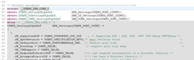

Second issue is that when I'm the stack is replying it's replying with a strange request for 0A current?
Could that be related to something that is (not) defined in usbpd_dpm_conf.h?
Because I find it strange that it defines external variables that are nowhere declared and the once that are declared from CubeMX are grayed/compiled out.

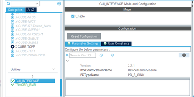

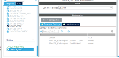

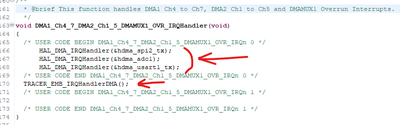

Well that was brutal!  As requested I enabled the TRACER_EMB
Enabled the GUI_INTERFACE
Recreated the skeleton code complied it without errors, but it completely ruined my application.
Nothing was working any more.  After some debugging I found that when enabling the TRACER_EMB the DMA interrupt section got overwritten entering the TRACER_EMB_IRQHandlerDMA() function but removing all other DMA handlers which basically the CubeMX (re-)adds without TRACE_EMB enabled.
To proceed I added them manually to make sure the remaining code remained working.

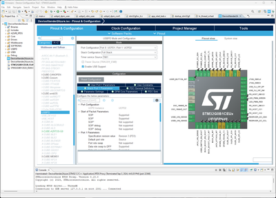

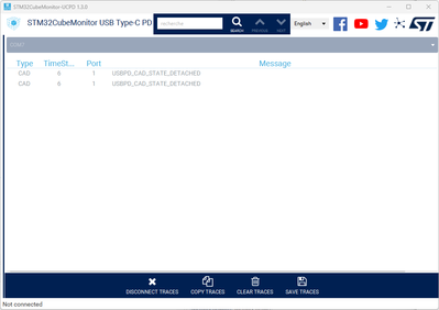

Now when running the code with the STM32CubeMonitor USB Type-C PD attached I get only this.
Each time I reboot the code the same entry appears, but nothing else is displayed not even when re-plugging the USB cable.
While my external CC-line tracer is able to capture this.
So much for the TRACER_EMB functionality, as I don't have much appetijt for spending time debugging the debugger here.

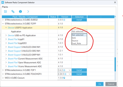

There is one topic that I needed to verify with you.
The instruction video's mention the use and configuration of X-CUBE-TCPP, while I'm not enabling it at all since it doesn't allow me to create one SINK and one SOURCE application.
And I'm also not using any of the X-nucleo boards or used parts either.
How does that affect the skeleton code created?
If you are not using the TCPPs, you should avoid using the CubeMX pack x-cube-tcpp...

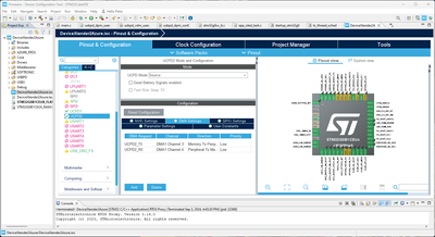

One question : are you looping port 1 to port 2 ? Have you tried to generate and test one port only (source or sink) ?
Not using any of the TCPP's, thanks for confirming that topic.
I'm not looping any of the ports both ports need to be handled individual.

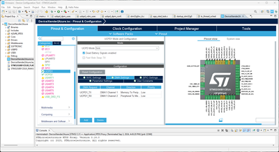

I'm focused on getting the SINK port working using an external USBPD charger adaptor, but the skeleton code is generated for both SINK and SOURCE.
Would it help if you can have a look at the project/code?
Nicolas P.
Yes, you can share your ioc.
But if the two ports are independent, it could be simpler to start first with sink port for example, and then source.
To avoid mixing multiple issues.
Hi Nicolas,
Sharing the projects IOC file here.
Would be good if you could return a working SINK example project based on this IOC that would allow me to continue build upon.
Meanwhile I'll try your suggestion of removing the SOURCE section from the project.
